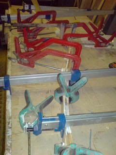

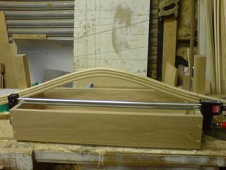

Iroko is a good timber for boats . Most timbers will bend easy if they are thin enough , how thin do you want the laminations ?
I laminated this handle up without steaming but it took a few clamps

Hi jfc, That's exactly what I am after, I thought 6mm strips was about right. Have you used a former to make yours? Can"t really see from the pics. Cascamite? PVA? EPOXY? POLY? glue any preference. I do have a bit of Iroko, but it is very pale. Any other ideas on timber type?

From memory i just put some screws into a board and bent the timber around those . Maybe do that so you get your shape and then slot a bit of pipe over the screws to stop them damaging the timber ? Or drill some holes for dowels and bend around those ?
