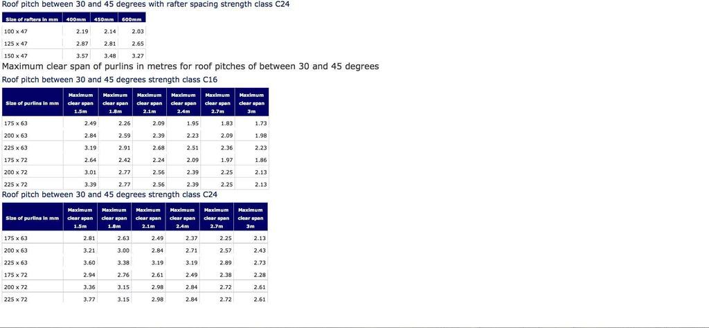

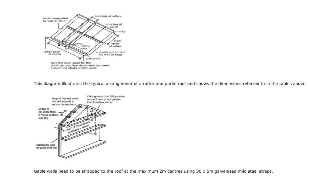

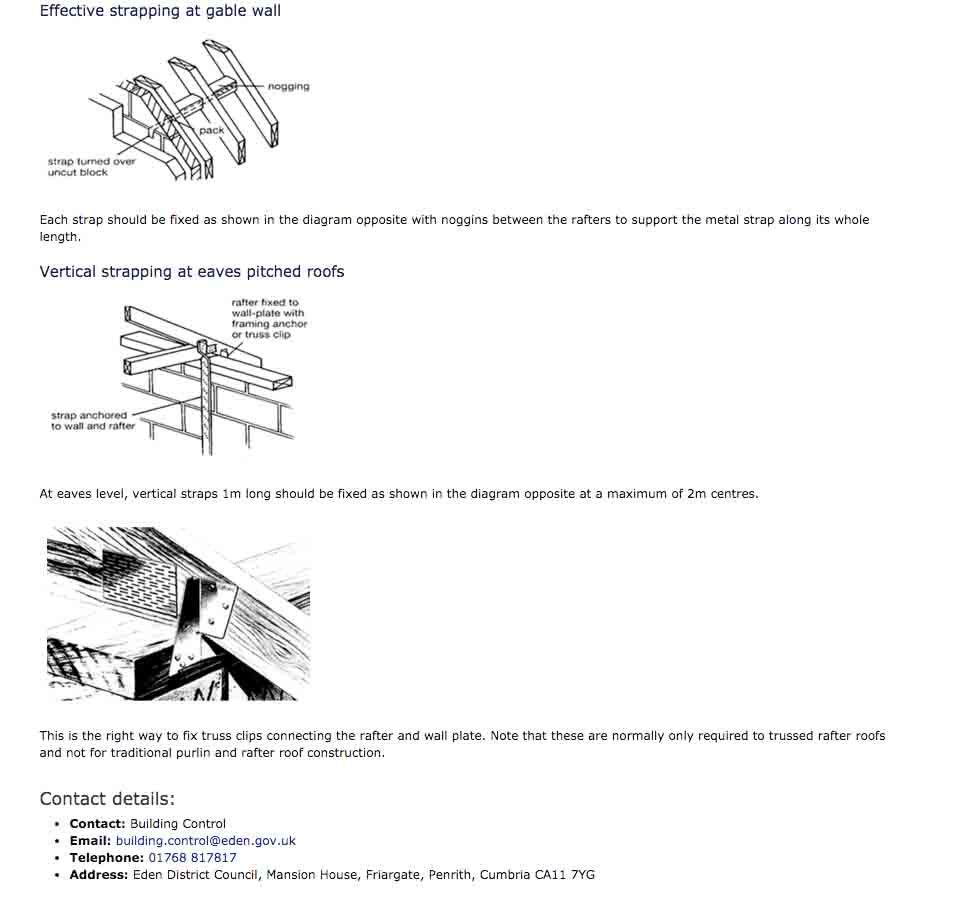

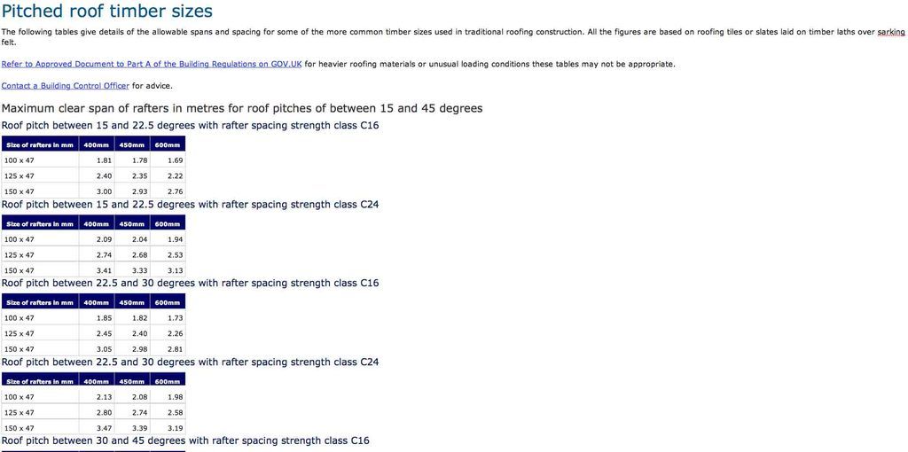

The below link should help with recommended timber sizes and spacing for your roof (useful to consult). The floor is different but you can find recommended sizes online for your floor span if you want. We used to use a rule of thumb:
1. Span divided by two (convert this figure to inches) then add two inches. This gives the depth of joist for a floor with joist spacings at 400 centres and 2" thick joist.
So if the span is 10 feet we would divide it by two giving 5 then we would add two to the five 5+2 giving 7" depth of joist for a 10 feet span.
The link below is for roof member sizes, and is a link to Eden council.
https://www.eden.gov.uk/planning-and-bu ... ber-sizes/

Posts: 768
Re: Roofing question
Post by Meccarroll » Sun Feb 17, 2019 11:45 am
Same information as in the link I gave above.

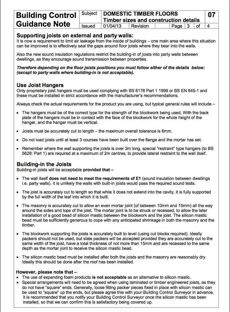

A bit more information on floor timber sizes which may or may not be useful:
Above taken from Lancaster City Council: Homeowner Guidedance In the Building Control Section.
The above are worked for domestic floor loads. Your roof has a pitch which means you can not use all the floor span. In effect your loading is very likely to be less than the above for several reasons, You are not likely to load all of the span with boarding etc (you also may not have plasterboard on the underside further reducing the load), meaning the above sizes may be oversized for your actual load conditions.
