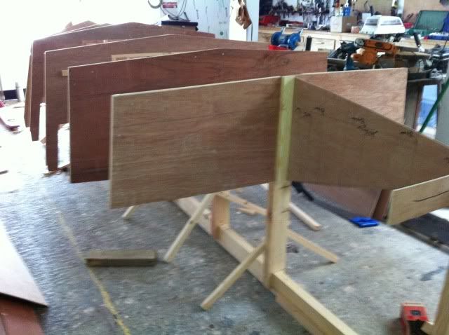

Hopefully one of these bad boys ......
Posts: 3321
Re: I'm up to something
Postby tusses » Tue Jun 26, 2012 8:00 am
isn't it spozed to be the other way up ?
EDIT- Not the last pic, the 1st one :)
Posts: 10583
Postby jfc » Tue Jun 26, 2012 8:32 am
These are just templates . We want to get them perfect before we make the real thing .

jfc wrote:Hopefully one of these bad boys ......
Bit late for the queens floatilla Jase, or is this for her next jubilee ?

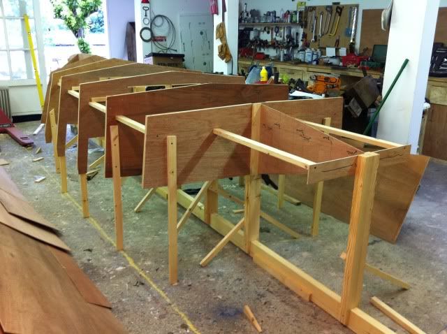

Postby jfc » Sun Jul 08, 2012 8:33 pm

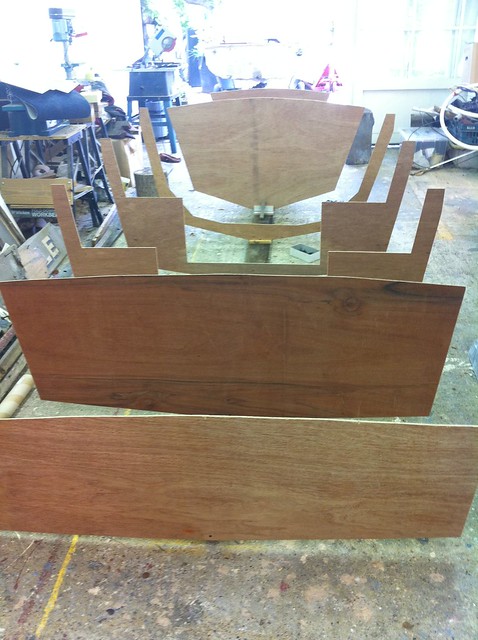

Been doing a bit more
A bit of a play untill the strong back is made
The strong back
Frames and moulds in place

These are all templates for the real thing . The plan is to build the hull out of cheap ply ( as you can see ) and then we have the templates and building jig for the real thing without wasting very expensive Lloyds approved marine ply . Get all the mistakes out of the way before we start if you like .

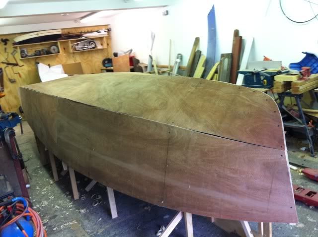

Got a bit more done this weekend ....
Braced up the frames and moulds
And got the hull panels in place

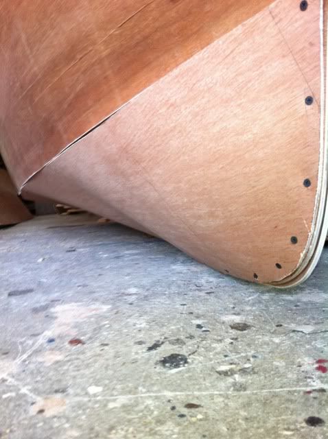

I can see gaps in the joins ... wont the water get in ? :?
Posts: 2484
Postby Doug » Sun Jul 15, 2012 9:30 am
tusses wrote:I can see gaps in the joins ... wont the water get in ? :?
Jase will fill those with his wax crayons when he does his colouring on the boat.

We are cutting up an outboard to power it . Untill the outboard is done we cant finish the hull as the motor dictates the shape of the hull .
