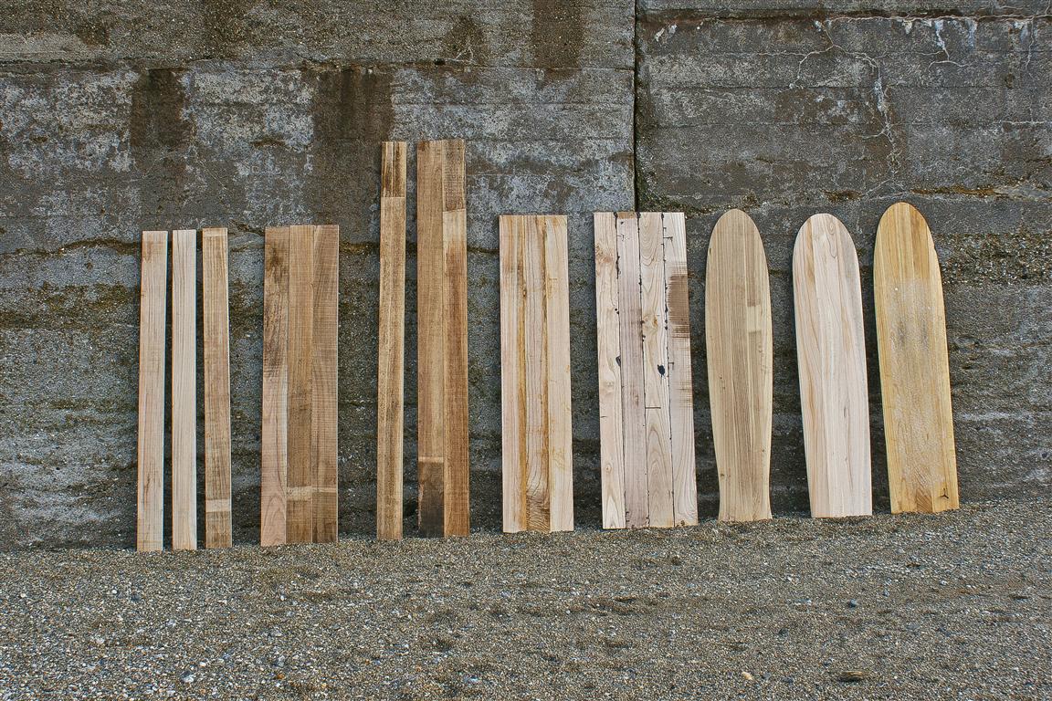

I m selling Paulownia Raw Timber.

I use it to built surfboards.It is very light, yet strong and flexy and does not soak up water as fast as balsa.
