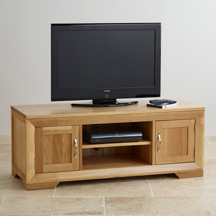

Re: Help Please- What size of oak planks to cut?
I just thought I'd do a quick search ...
Oak Furniture Land ..
IMHO it's crap .. but people buy it !...
oldclaypaws
- New Member
- Posts: 10
- Joined: Sun Jan 24, 2016 8:21 pm
I agree. Imported Chinese made oak 'furniture' would more accurately be described as matchwood models- they seem to be a laminate of small oak scraps. Its true they are solid oak, but maybe 10% glue in addition. Presumably the source is all manner of European oak offcuts and various upper branches. Doesn't say much for public taste, but then most of the herd never had any.
