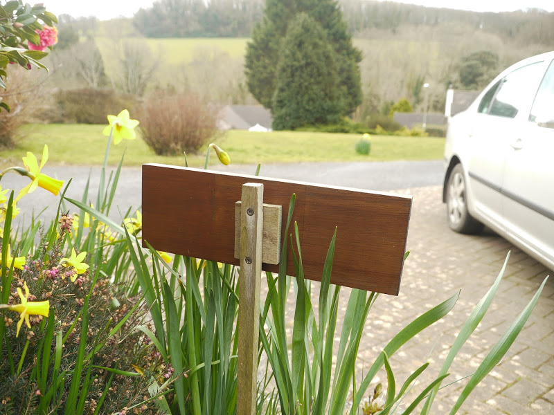

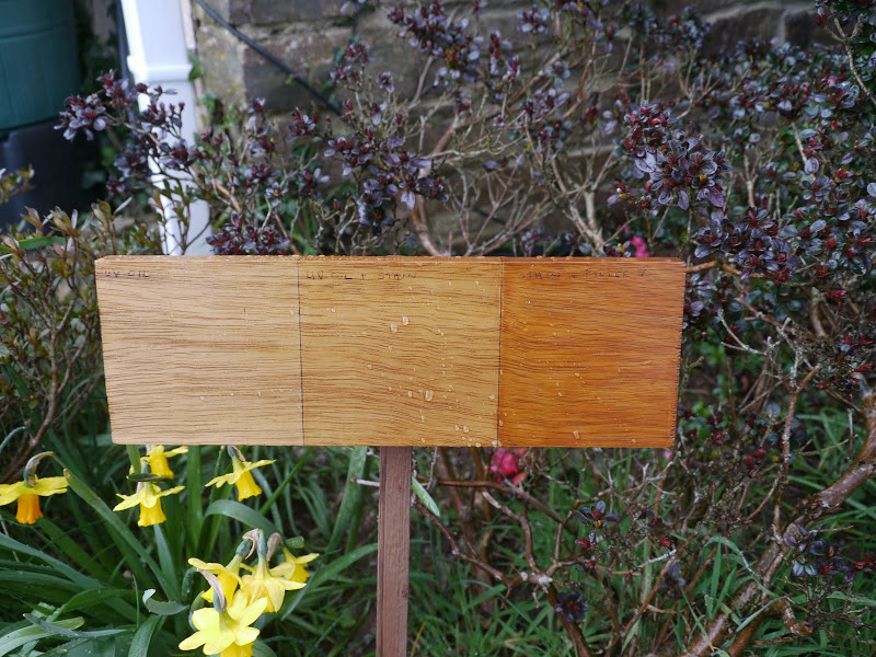

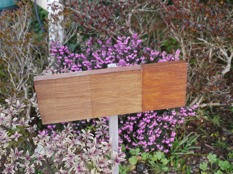

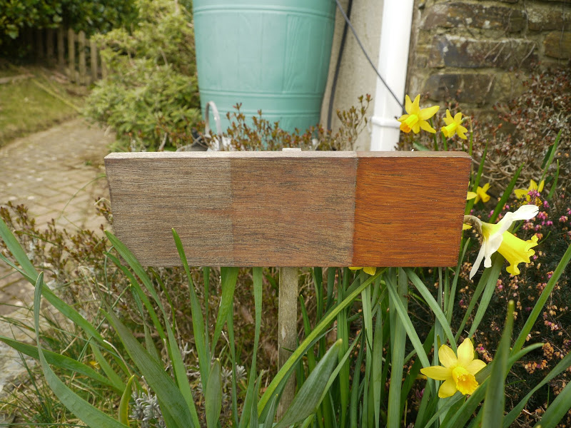

I've used an offcut of pale iroko, and from the left I have 3 coats of Osmo UV Oil, then one coat of Sikkens Cetol HLS Plus light oak stain covered by 3 coats of UV oil, and finally on the right one coat of Sikkens Cetol HLS Plus light oak stain followed by 3 coats of Sikkens Cetol Filter 7 plus light oak. The test piece is out in the open facing due south in full sun so we'll see what happens. I'll update the thread at approx 6 month intervals, or when I remember or when asked.

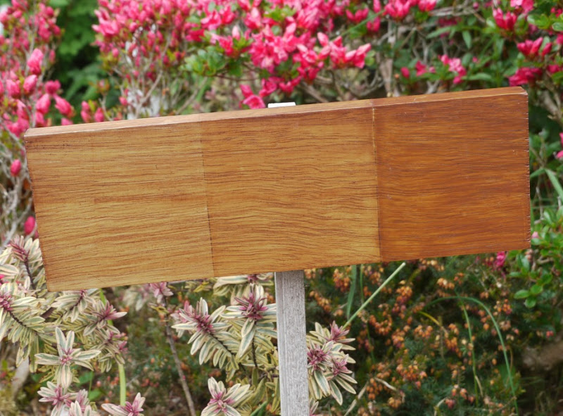

Well, so far as iroko is concerned we'll find out won't we!
The reason I've used a pale oak stain under the UV oil in the middle section is to see whether the stain makes any difference. I also prefer the natural wood, but suspect that some pigment is needed to enhance the UV protection. It'll be interesting to see.

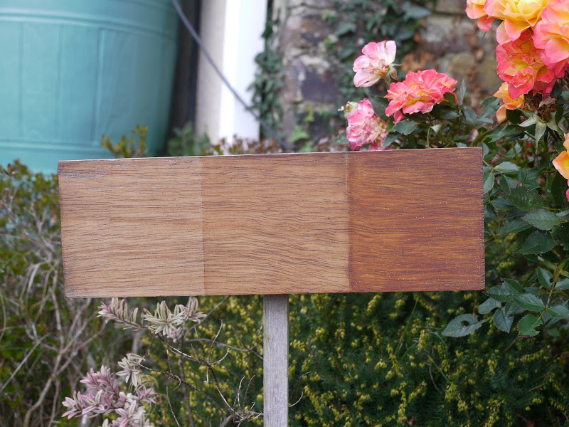

All 3 seem to be standing up well. Predictably, the wood has darkened so that the difference between the far left and the centre panel is less marked, but all seems fine so far. The test piece has been in full sun and open to the weather.

They are all standing up well. However, as you can see, there is very little difference between the UV oil over the stain compared with the UV oil on its own. There is a narrow line of grey along the top edge which may be due to UV getting to the wood from both sides near the edge. The Sikkens is still looking solid and if this were joinery I wouldn't feel the need to repaint yet. The position remains facing due south in full sun. I don't think that if you are using iroko you'll need preservative. So far, based on a combination of this test and some iroko doors and windows, I would stick with the light oak stain under Sikkens Filter 7. But time will tell!

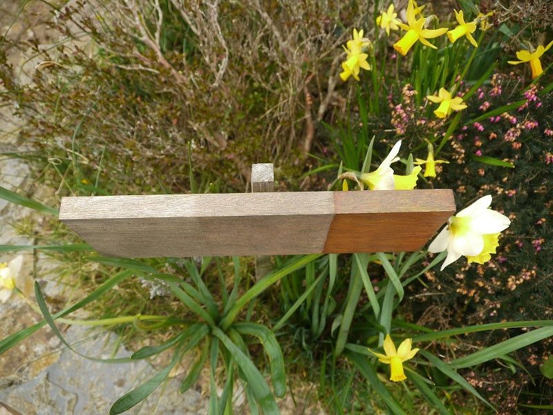

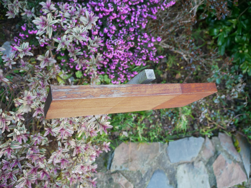

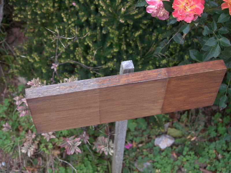

Getting a bit scruffier! Now nearly 2 years old - including 2 summers.
The section of the left which is just 3 coats of UV oil is showing severe breakdown along the top of the specimen, and it's starting to show signs of grey along the front as well.
The centre section, which is one coat of Sikkens Cetol HLS Plus light oak stain covered by 3 coats of UV oil is slightly better, which seems to indicate that a bit of pigment does help, which is hardly surprising given that sunglasses help as well.
Finally the one on the right has one coat of Sikkens Cetol HLS Plus light oak stain followed by 3 coats of Sikkens Cetol Filter 7 Plus (light oak), and this is still holding up well. There is slight greying along the front edge, but the front face and top is generally looking good. I reckon that if I had chamfered the edge, or rounded it slightly that would have held up as well.
Ignore the white spots - back in the summer some idiot
sprayed his kitchen doors nearby and the overspray drifted over the test piece.
Incidently, the back of the speciment which was treated in exactly the same way and is in the shade, is pristine, and it is slightly disappointing that a product that is marketed specifically as UV Protection has come out the worst. Whilst Osmo would probably claim with some justification that this is not a scientifically controlled test, and one specimen is not enough, this IS a real world test based on how people actually use the product in real life.

The one the right which has one coat of Sikkens Cetol HLS Plus light oak stain followed by 3 coats of Sikkens Cetol Filter 7 plus light oak looks to be holding very well. I will be trying this as we make a lot of iroko planters

No change from the photos above taken about 2 weeks ago. The back of the piece is as good as new. What is clear is that it is sun that is the real problem, not wet weather.

A quick update.
This piece has been in full sun and salty wind ( we live on the coast) for 2 1/2 years now. This is the end of the 3rd summer. The left side (3 coats of Osmo UV Oil) is faring worst, particularly the top edge, where not only has the wood discoloured, but the finish is peeling. The centre panel (one coat of Sikkens Cetol HLS Plus light oak stain covered by 3 coats of UV oil) seems to be holding up a little better. By far the best though is the right panel (one coat of Sikkens Cetol HLS Plus light oak stain followed by 3 coats of Sikkens Cetol Filter 7 plus light oak). Whilst this is beginning to show signs that it is weathering, I think it will probably last another summer before it would need repainting if it were a piece of joinery. However, I'll just leave it to continue weathering to see how it lasts.
Ignore the white spots on the front of the piece. Some dipstick sprayed his kitchen doors on the driveway and the overspray drifted onto it!

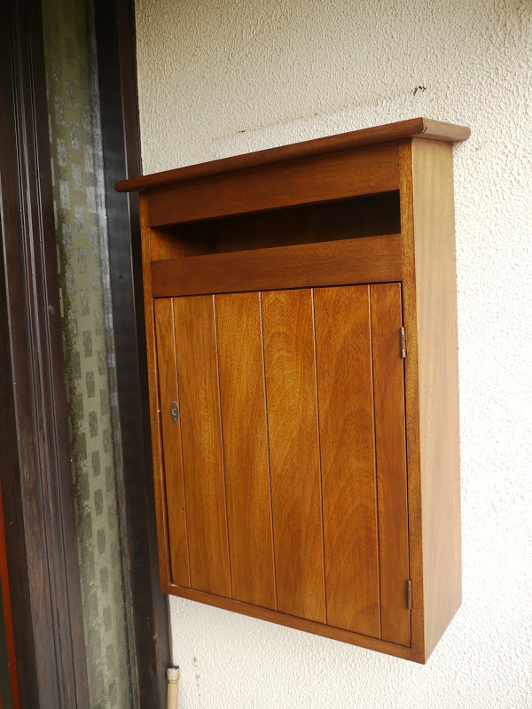

Can't believe it's 17 months since I reviewed this.
This test piece has now been exposed to the weather for exactly 4 years. The left side - 3 coats of Osmo UV Oil has continued to deteriorate and there is little sign of any protection left. The centre panel (one coat of Sikkens Cetol HLS Plus light oak stain covered by 3 coats of UV oil) seems to be holding up a little better, which demonstrates that you do get some extra UV protection from pigment. The best though is the right panel (one coat of Sikkens Cetol HLS Plus light oak stain followed by 3 coats of Sikkens Cetol Filter 7 plus light oak). The vertical part is remarkably good, although the top/horizontal edge is showing signs of weather. After 4 years in a salty environment facing south in a particularly sunny spot, this is hardly surprising and if it was external joinery I would be redoing it this year. It case there is any doubt as to whether it is the sun that is doing the damage, I've also posted a pic of the back of the piece which is in permanent bright shade, and none of the finishes have been affected to any noticeable extent.
This is the same Sikkens finish on a sapele post box which gets full sun for half the day, applied about a year ago. No sign of any degradation yet.
